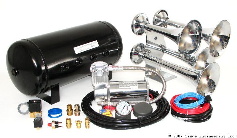

    And check these guys out ... Awes. eBay Store - train horn: air horn, siege, engineering
    I could see Tys or Starfish fitting one of these to their lounge chairs ...
    [ame="http://www.youtube.com/watch?v=2-iyvBqJgSY"]YouTube - Train horn test (www.gigabitcustoms.com)[/ame]
    (or Hornet, to announce those FNR's)
    [ame="http://www.youtube.com/watch?v=W5L5Gkef2bY"]YouTube - Train Horn Demo[/ame]
